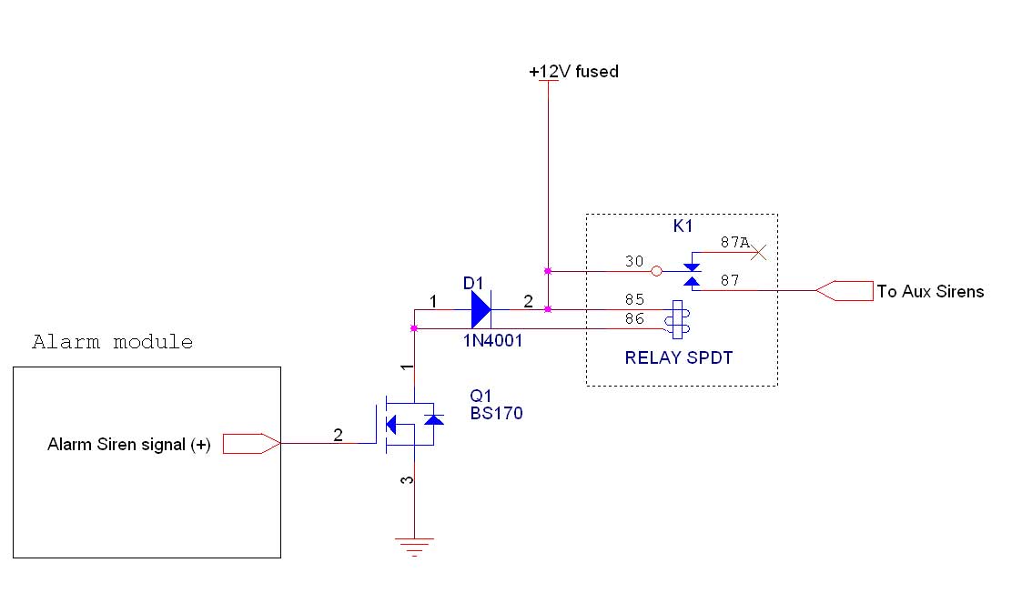

Seems strange that your alarm's siren output isn't enough to chirp when you just add another relay load to it, but if that's really the case, you could add a MOSFET transistor in between the siren output signal and the relay.
Then your original siren signal won't be affected, and you'll get your arming chirp, while being able to drive the relay for your aux sirens. All you'd need to add is a 10 cent BS170 transistor and 1N4001 diode to protect the transistor against the relay turn off voltage spike.

Dualsport....would you mind explaining how to wire the transister into my circuit. I understand the diode portion of it and I know what a transister looks like.
So it would be wired it this order....original alarm siren circuit, then splice into that with a wire, then the transister, then the diode with the band facing the relay and then the relay. Since the transister has 3 wires how would that be incorporated inline on that siren output signal wire?
Thanks guys for all the help. I think we are very close in figuring out a solution. I will stop by Radio Shack tomorrow and pick up the transister so when Dualsport replies I can wire it up and see if it works.

This is a general setup you can use any time you have a low current drive signal driving a relay. The transistor works on voltage only, rather than current.
It won't load down the signal so you can leave the original connections to the main siren as is, and just tap off it.
The pulse duration isn't a problem for the relay, since you found that it worked when you disconnected the main siren; it's just that your alarm output doesn't provide enough current to drive the reactive load.
Multiple Sirens Relay Problem -- posted image.
Not sure if Radio Shack stocks the transistor, let me know if you have problems finding it- I usually get things from mouser.com or digikey.com, good if you want to stock up.
