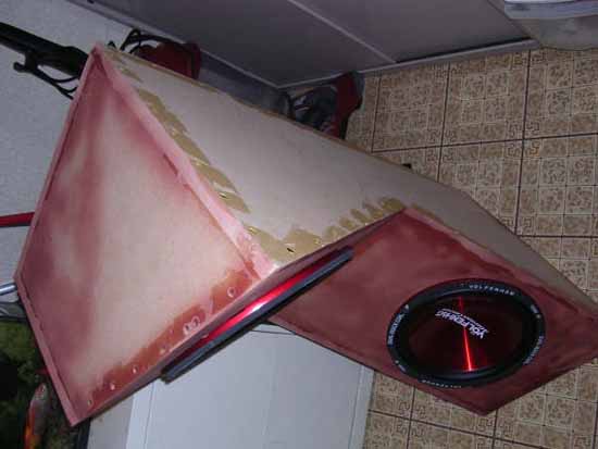

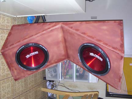

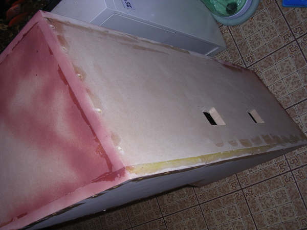

I have the same issued, and if anyone is still reading this post I have attached a photo of my box in progress. Ask any questions youd like. I used basically the same principle as setvdart says with the cardboard. I spent hours cutting and hot gluing cardboard together to get a shape that fits exactly - even built exact size subs and amp so I knew I would have no problems later..... The amount of cuts are insane, the angles as well be prepared to waste a few pieces of mdf if thats what your using just from cutting a wrong angle. The picture is pre-amp rack and pre covering which I wont be doing for a while. Make some comments.

The setup is going in my 2006 Toyota Yaris in the hatch. It fits perfect between the wheel tubs. I didnt want to cut up my car and it has to be removable. It tucks in behind the back seats, under the stock parcel shelf and between said wheel tubs. You dont see it unless the hatch is up.
The amp rack is 3/16 x 1.5 inch steel which will bolt to the box at a slightly steeper angle between the two subs.

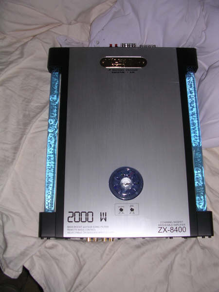

Ive also included a pic of the amp.
