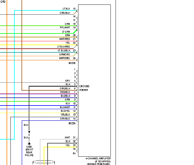

Some moron cut all the wiring harnesses in this guy's '94 Nissan Quest, and NOW he wants to bypass the factory premium sound amp. I don't want to have to run wires to each speaker, so if anyone knows the location of the factory amp I'd appreciate it. Just looking to save some install time here.

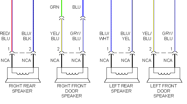

here are the colors at the speakers as well as the amplifier
'94 Nissan Quest  premium amp location -- posted image.

Is up to the installer to test all wires with a DMM whenever possible.

Excellent! Any idea which trim panel it's behind?
Never mind, I just found it. Left rear well.
Thanks again!

Yes , I have done those the panel si the one all the way in the back on the drivers side

those are exactly identical to the mercury villagers if memory serves. You should be able to use the metra ford amplifier bypass plug, saves alot of time. part #70-5513

I have one.  That's exactly what I'm going to do now that I found the amp. I just wanted to cheat a little search time off the install.'94 Nissan Quest  premium amp location -- posted image.
