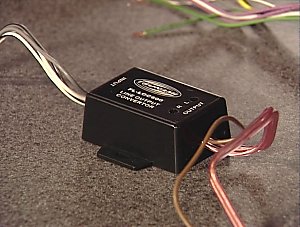

94 dodge intrepid, amp to factory hu? -- posted image.
this is what the converter looks like

The WHITE wires and the GRAY wires are your speaker input wires. One for left and one for right. The BROWN wire is a GROUND wire that helps the LOC ground so you don't get as much interference in the lines.

i usually don't use the grounds on the inline converter. i haven't ever run into a situation that needed them. someone told me one time that sometimes in older vehicles it will help keep noise out of the system but i haven't ever had to use the brown wires at all. good luck!
