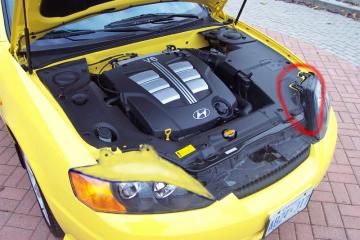

hey guy im new to tis site and i just got a question about some fiberglass work im trying to do my buddys eyelids for a tiburon and and having a hard time doin it what the best way to go about doing them.

when u pop open the hood u should be able to see the top of the light case. Could u tape off the top and front of the light and then glass it and build onto that? Even better would be if u could use existing bolts...just unbolt the bolts u want to use then tape off everything and when the FG is hard and the tape is removed just mark where the hole is and drill through the glass and bolt it on.

Ill agree with placid....but, make sure you tape around the holes before you drill them, If tape them youll have a better chance of getting a clean hole...I learned this the hard way and cracked my body kit....good info placid and good luck pmpdoutexpo.

having problem doing the eyelids i am using fiberglass cloth and resin and hardner.  we cut strps about 2 inches bigger than the eyelid on each side and then soaked them with the resin we used about 4 layers of fiberglass cloth on each on and after they stoped givin off heat they were still very flimsy and when i cut them to the shap the edges were fraying.  any help with this is greatly appericiated because wee have to get them done for a show that is commin up
