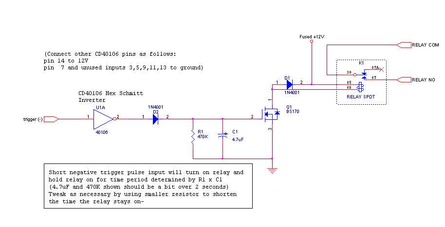

If it turns out it isn't programmable and the commercial options don't work out, you can roll your own, so to speak.
Depends on how much you're willing to tinker-
dualsport
Silver - Posts: 983
Joined: September 27, 2005
Posted: March 24, 2006 at 9:08 PM / IP Logged
If you want to play:
Timer for short trigger pulse? -- posted image.
