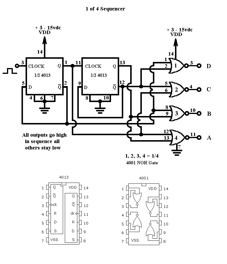

Here is another type only one light lights up at a time.
Sequential tail lights -- posted image.
