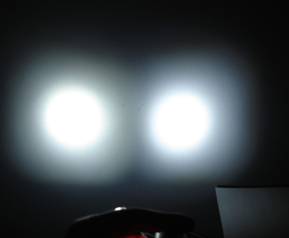

Lower color temps typicaly have higher light output @ the same power. But since our eyes have more color cones than light cones the blue tint makes the light look a little brighter.
The LED on the right has a CCT of 8000K and the light output is 80 lumens.
The LED on the left has a CCT 0f 6300k and the light output is 105 lumens.
Both leds have a Vf of 3.9 volts and are being driven @ 1 amp.

Dont buy any bulbs that say they are HID. In order to have a HID system, you need a custom wiring harness, ballest for each light, projector assy, DS2 bulbs, some type of lense to put the projectors in. Typical OEM Hid kits run about $500, that is a little less than what I paid for my Bi Xenon Hella kit.
Please dont buy those so called "HID bulbs." As you can see the pic in the above post has massive glare and is highly illegal.
I see that the author has posted over at HID planets forum, do some searching there. You will see pics with sharp light cut-off patterns, that is what you need to have.
