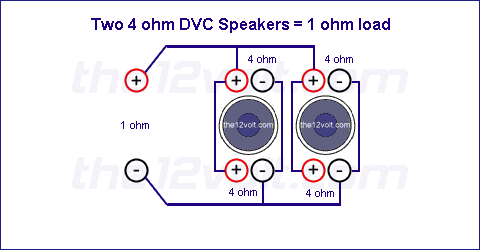

5- For the Subs is the following connection correct: 1 wire to +(1Sub) & +(2nd Sub)
                                                                           1 wire to -(1Sub) & -(2nd Sub)
                                                                           1 wire to + & - (1 Sub)
                                                                           1 wire to + & - (2nd Sub)
will this 2 subwoofer set-up create a 2 Ohm or a 4 Ohm Load?

5)  If you are planning on bridging that amplifier, you can only provide a 1 ohm, 4 ohm, or 8 ohm impedance to your amplifier.  Here's how to do the wiring: https://www.the12volt.com/ssi/getimage.asp?imgFN=2_4ohm_dvc_1ohm.gif    https://www.the12volt.com/ssi/getimage.asp?imgFN=2_4ohm_dvc_4ohm.gif
