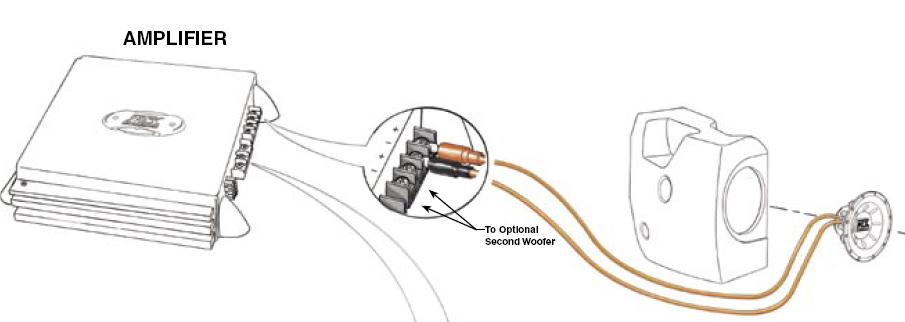

Yes, those mtx 801d are mono amps and they have 2 terminals but they are not 2 channel amp, (that is what confusing people)they have 2 terminal for making it easy to connect 2 subs on it, imagine you want to connect 2 subs and you have 1 terminal it will be more dificult to connect compare if you have 2 terminals, right? wired your subs coils in paralell so it be 2 ohm and connect it to your amps as the image below. the amp it self connect internally(like Ravendarat said) at 2 ohm and give you 800 wrmsWiring solutions for MTX amp&sub -- posted image.

Thanks for all your help and knowledge into my delima.  I appreciate the time you guys took to answer my question.  I am going to wire up my MONO class D amplifier to the sub the way you guys recomended. One on of the provided channels on the amp and they way the parallel wiring dirgram stated.
