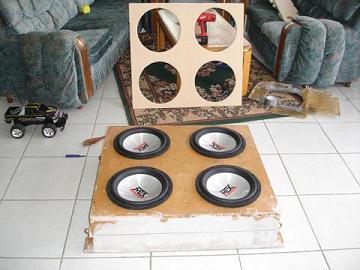

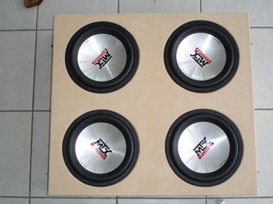

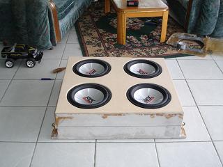

I've made mine with 1/2" of mdf those of the mtx is made of 1" mdf i think, don't remember right now. you can see the pictures of mine.

yes, it could appear the same depend how they paint it, with mdf you don't have to resin it, just sand it with wood sandpapers of 120 grit then 240 grit and at last iron sand paper of 500 or 600 grit and it will be very smooth. the one in the picture is sanded with those number of 120 160 and 600 grit sandpapers.
