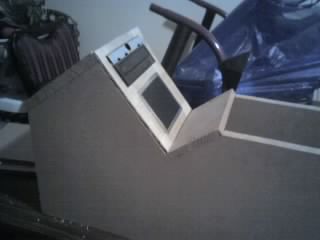

Ford explorer progress -- posted image.here it is the ford explorer eddie bauer edition.
Ford explorer progress -- posted image.i skipped a couple step in the progress tree so that i can keep this short and simple.

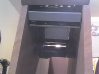

what you see there is the console walls with a pc 3 cd drive 1 floopy and 1 hard drive slot bracket I found in a hp pavilllion I took apart long ago and a dvd drive in it and covered the lower portion with a cardboard template of what im gonna do with the mdf for the lcd screen of course the mdf will cover the whole area not just the lower but its for testing purposes at the moment.

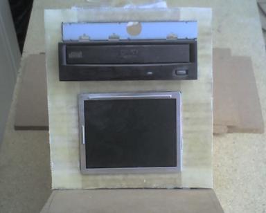

Ford explorer progress -- posted image.strange and lucky for me this braket had a hole in the top center that was an exact fit for the power button and i will drill holes for the led's to fit nicely into place. For this car pc i plan to add a sound card and at the moment looking for the slot card for a laptop wireless g card i got so it can connect pci to the mother board, the stores dont have them in stock and i hate waiting for online orders or any mail order at all.

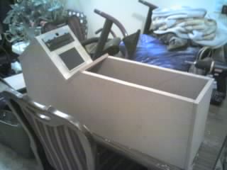

Ford explorer progress -- posted image.Ford explorer progress -- posted image.
im thinking about adding this below the screen so i can have a quick place to drop cds and other items i might be fumbling around while driving, maybe my remote controls and mouse.

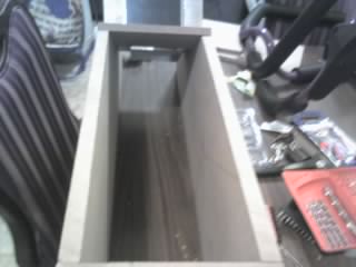

Ford explorer progress -- posted image.Ford explorer progress -- posted image.in this pic the track isnt where it belongs i plan to cut a new space for this storage compartment but i m not sure yet if i want it.

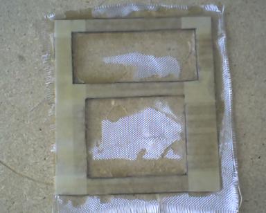

here is the progress so far.....
Ford explorer progress -- posted image.this is just a cardboard template covered in masking tape and resined down real good i used fiber glass cloth to achieve a flat and stronger build also i never removed the cardboard and tape because it soaked up lots of resin. its really solid.
i had to make a fiberglass face for it due to the dificulty i have cutting wood "lol i suck at it" Ford explorer progress -- posted image.
