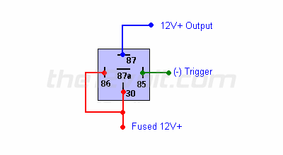

i installed everything, and it all works great. what i was wondering now is, the trunk is able to be opened with the factory remote. how do i go about doing this with the r/s

At the BCM (  located to the left of the steering column above the kick panel. ) you will find a BLACK/ WHITE wire (+ ) trigger that will need to use a relay to reverse the polarity on in order for the Viper system to operate it. You can use this diagram for the polarity change.

2000 cavalier, dei 791vx? -- posted image.At the bcm BLACK/ white pin a5 should be a violet plug. Its positive trigger at the bcm. You may have to wire up a relay to switch the remote starts trunks out put from negative to positve. I am not sure on the dei's stuff. I'll post a diagram in a min.

ok. but where on the r/s module would i hook it up to

Pin 85 on the diagram XtremeJ posted would connect to the H1 RED / white channel 2 output.
