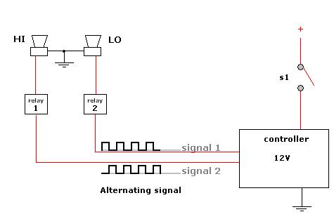

Hello!
I'm making old euro-type siren (HI-LO) from auto-horns. They have two different  frequencys. I want to hook up one relay for each horn on controller.
1. I need wiring diagram for controller.. any suggestion?
2. Can I hook up just one alternating relay on NE555 oscillator?
3. I need to know how strong is the trigger current on standard auto relay. Is it 200 mA?
Thanks, Samo

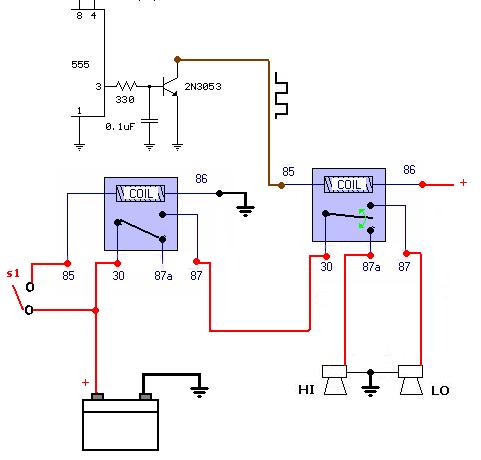

rajkovic
Joined: April 26, 2006
Posted: April 26, 2006 at 2:49 PM / IP Logged
Could this wiring work!?  Alternating horns -- posted image.
Just need a quick check of the diagram, which I draw.Alternating horns -- posted image.
Thanks,
Samo

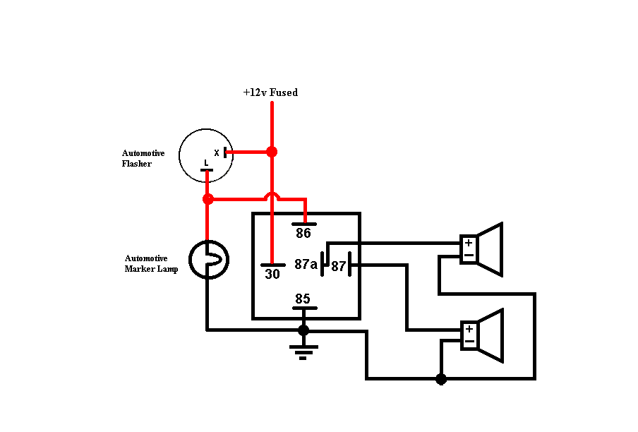

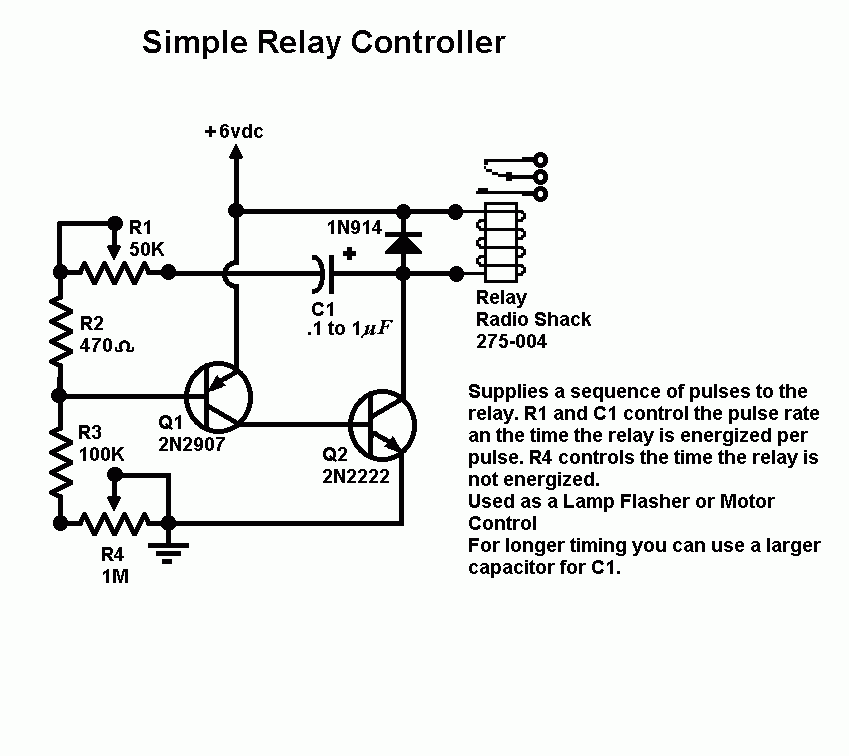

hotwaterwizard
Silver - Posts: 1,350
Joined: December 11, 2003
Posted: April 26, 2006 at 11:17 PM / IP Logged
A simple relay controller with transistors would work as well.Alternating horns -- posted image.

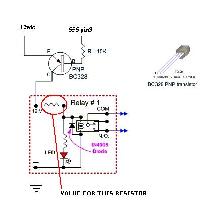

hotwaterwizard
Posted: April 27, 2006 at 12:08 AM / IP Logged

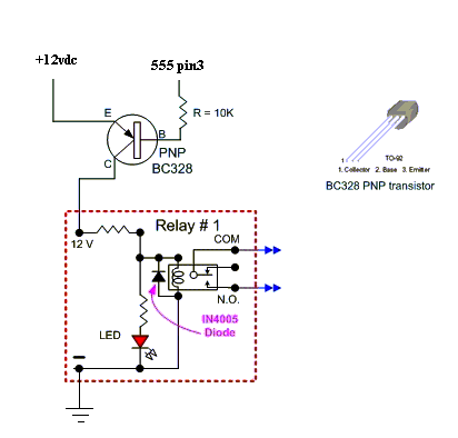

You could use a regular Automotive Relay if you add a transistor to the output of the 555.

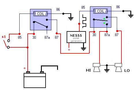

rajkovic
Posted: April 27, 2006 at 3:30 PM / IP Logged
I appreciate your help. I need to run my horns on 12V dc, so I dont think the first one will work.  Well then, I' ll use my configuration of two relays and connect the 2. hotwaterwizards configuration on second relay.
I thought that NE555 chip is capable of running 500mA on exit. Alternating horns -- posted image.
Thank again....Alternating horns -- posted image.
hotwaterwizard
Posted: April 27, 2006 at 8:46 PM / IP Logged
I found a better transistor interface.Alternating horns -- posted image.
http://www.overclockers.com/tips1122/index03.asp
