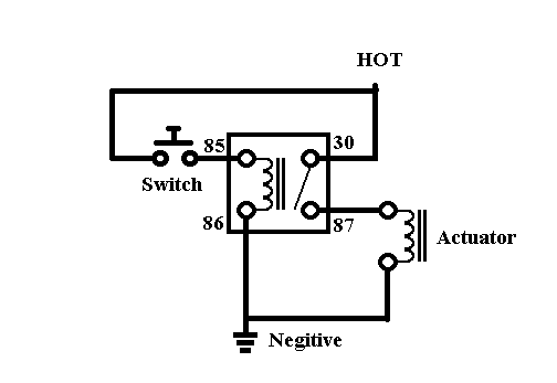

First off this is an awesome forum.
Second, I am shaving my door handles and I have purchased 45lb actuators. I am installing a simple push button switch on the outside of the SUV to open the actuator if my alarm remote dies. Can someone explain where on the relay I would connect everything.

Posted: April 30, 2006 at 12:18 AM / IP Logged
Simple relay switch -- posted image.

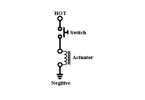

Posted: April 30, 2006 at 12:27 AM / IP Logged
You could just use a switch instead of adding a relay since the amp draw is less that one amp.

hurley1718
Joined: April 27, 2006
Posted: May 01, 2006 at 12:21 PM / IP Logged
I need to use a very small alarm valet switch and I don't want to burn it up. Thank you very much for the diagram.
