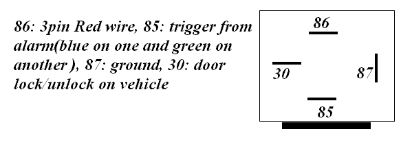

Would this work or be worth trying? The 3 pin Red wire is 12V from the alarm for relays.
1998 Dodge Caravan, alarm/remote start -- posted image.

That worked!

I hit the post reply to quick. It worked for the door locks. I'm still needing help with the alarm disarm. I'm going to try the same thing for that.

You probably need a stronger Ground Pulse on your Lock & Unlock.  You will have to use 2 Relays.
OMEGA makes a Dual Relay Pack that has the Resistors Built in. Omega # DLR-U
