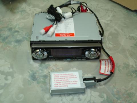

Forbidden i just bought the Eclipse CD8455 and it looks very great but there is a thing that i don't know what it is, i search for it in the owner manual but i can't find what it is, what is the small part with the wire in front of the HU as shown in the pic? and where should a mount that thing? anyways, thnx.

That's the ac/dc converter. Try some double stick tape or velcro, make sure it is secure behind the dash and away from other electroinc components.

What he MEANT was DC to AC power supply, and it is for the display power. It is a high frequency switcher, and is a NOISY bastard, electrically speaking. Keep it away from your antenna leads, and especially your RCA cables.

I have had a couple of eclipse decks and they all have that nifty little device. I too was quite curious what it was. All I knew is that the sticker said to keep it far away from all other wires and what not so you dont create speaker noise. That is why it has such a long cord.
