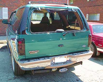

Thanks again. BTW, here is the result of not having an alarm and the reason as to why I am getting one now before I put stereo equipment back!
1997 Expedition Alarm/Remote Start ? -- posted image.
F***ers took my 15" L7 Solobaric which had a big hole in it but my buddy who does autobody fixed it with resin lol. They also took my Directed 1100d5 - 5 Channel amp. Lucky they did not mess with the head unit - it's an N2. I had the face with me, so I guess they figured it was not worth their time.
