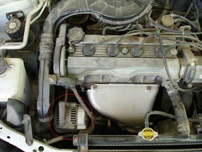

Thanks Jeff, here's the pic of my car's motor.
i doubt i can fit a larger case GM style Alt in it, i think i'll go with the Ohio, i don't know what's the higher Idle Amperes i can get from of Excessive Amperage. anyways, thanks a again Jeff.

That's pretty tight in there, but I bet you could get one in there. Go to a junk yard and buy a junk alt that is the same size as that Ohio. Then do some fab work to see if you can mount it. If you can, then order that Ohio. If you can't, you only spent a few dollars on that junk alt. I think you can do it. remember to upgrade your grounds and power wire's. See "The Big 3"  I think you could move your radiator over out of the way to. You pic does not show the left side of your car so I can be sure

thanks SpeedW. no the Ohio can fit nicely, but since it's putting only 75A at Idle and 160A at max it will not be enough, the Idle Amperes is what is more important for me. if i can get one that put higher Amperes at idle it will be fine in my case.
I've already done the Big 3 as you can see in the pic. the white color 1/0awg cable in front of the Alt. the Alt you see in the pic is an Iraggi Alt. that supose to give me 120A at idle and 160A max, but when they test it for me, it's putting only 54A, so i have bad experience with Iraggi and that's why i'm thinking about an respectable brand like Ohio but again, there start another problem the not enought current at idle. anyways, thanks SpeedW.
