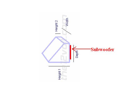

your measurement of W-15, H1-15, H2-15, D- 12.5 and .75" tickness the Interior volume will be 1.16016 cuft, but if you do it so it won't be a wedge enclosure anymore because of the H1 and H2 are the same size, you have to do it like this: W-15, H1-15, H2,12.5, D-15 and .75" of tickness then the Interior volume will be 1.29199 cuft, but 1.29 cuft is to big for that sub.
W-14, H1-14, H2-8, D-12.5 and .75 tickness then the Interior volume will be 0.75593 cuft Sealed Enclosure thus much better for that sub.
and if i was you, i'll use it so like in the pic below,

Oops.. I put in the wrong number for the h2, I meant 4 not 15 my bad.
Would a square box be better? Or about the same?  It would be easier to build I do know that..
