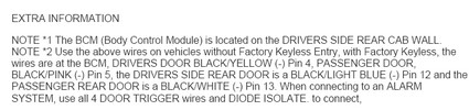

2004 f150 door trigger not working -- posted image.

this tech sheets says one wire will trigger all doors . try and test  circuit see if this helps you.
<a rel="nofollow" href=" http://photobucket.com" target="_blank"><img src=" https://i2.photobucket.com/albums/y31/kinnetik/04ford.jpg" alt="Photobucket - Video and Image Hosting"></a>

I don't recomend using the "one wire" method, you can shut that wire off at the light switch by turning OFF your dome light. = no door trigger.
Use the 4 individual wires (actually you only need the 2 front doors)
