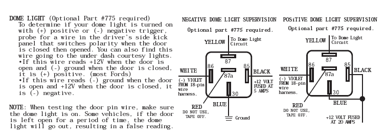

does anyone know what switch type this truck is and also recommend a wiring diagram for the 2 relays. the truck has a 5 wire harness, a blue and black w/red that respond to lock and unlock, any help is much apreciated I have spent 2 days on this and fried one alarm module after hooking up the relays.

https://www.the12volt.com/doorlocks/page3.asp#5w
POWER LOCK       LIGHT BLUE (TYPE C) See NOTE *1       IN EITHER DOOR BOOT
POWER UNLOCK       BLACK/ RED (TYPE C) See NOTE *1       IN EITHER DOOR BOOT
refer to the diagram, i did one awhile back, but i had to add my own actuator.

Captainzab,  I think the other module went dead I was working fine before I tried to wire the door locks. I heard some clicks from the relays and then the siren did not work anymore and the led just flashes about 8 times, pauses, flashes again. I went to get another alarm and that is why I want to make sure I do right wiring for the door locks. the diagram that you suggest, is it the polarity type on 94 chevy -- posted image. 5 Wire Alternating 12 Volts Positive Door Locks?

Yea, full size pickup 2 doors is type C, and that link is for type C (5 Wire Alternating 12 Volts Positive Door Locks)
I really dont think you can fry your brain from wiring a bad relay. Try unplugging your brain and chill for awhile. Then look at your relay set up, it should be exactly like the one pictured.
