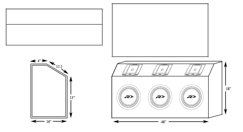

Here is the drawing of what i want to do. Only the front panel will be fibreglassed because i want to change the angles of the subs, the outside subs will face inward a bit, and the middle sub will be angle'd upwards.
I am also wondering, will I need to support the subs from inside? (something underneath holding them up to relieve stress on the front end?) What do you suggest?

My box was similar to yours, and no i didn't use anything to support the sub from the inside.  Just make sure you use plenty fiberglass mat especially around where the sub rig attaches to the box.

Thats a pretty sweet desing. My only suggestion would be to maybe think about angling the outer subs outward instead of inward. Inward subs might cancel each other out.
