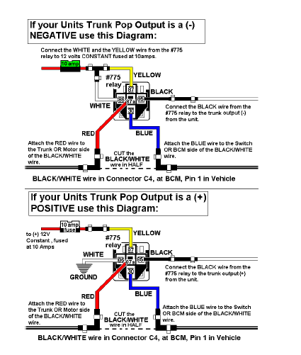

Directechs calls for a 5 wire on the trunk release.  I have a negative output from a Avital Remote Start/Keyless for trunk release and I need an explanation of how to wire this into this.  Thanks.

you need a relay and wiring harness for it first, if you have that, look at
http://www.commandocaralarms.com/trunkrelease.asp
that will tell you where to connect each wire

03 Dodge Stratus -- posted image.
