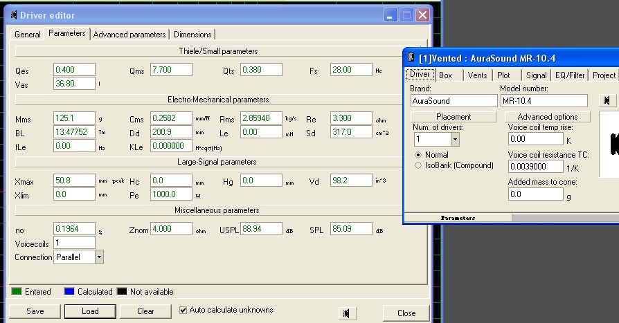

Anybody got a complete set of those? I can get em... just don't want to pull my gear out to spec one woofer. It's the MR10.4... the one with the neo magnet structure, aluminum cone, and the "Chroma Flair" paint job... I found some, but I was hoping to get some more complete specs, as JBL wants more than I have for more accurate figuring...
Was hoping to build an A-#1 BITCHINEST multimedia subwoofer with it... a 10 inch with a 15 in PR... what'ya think? <grin>

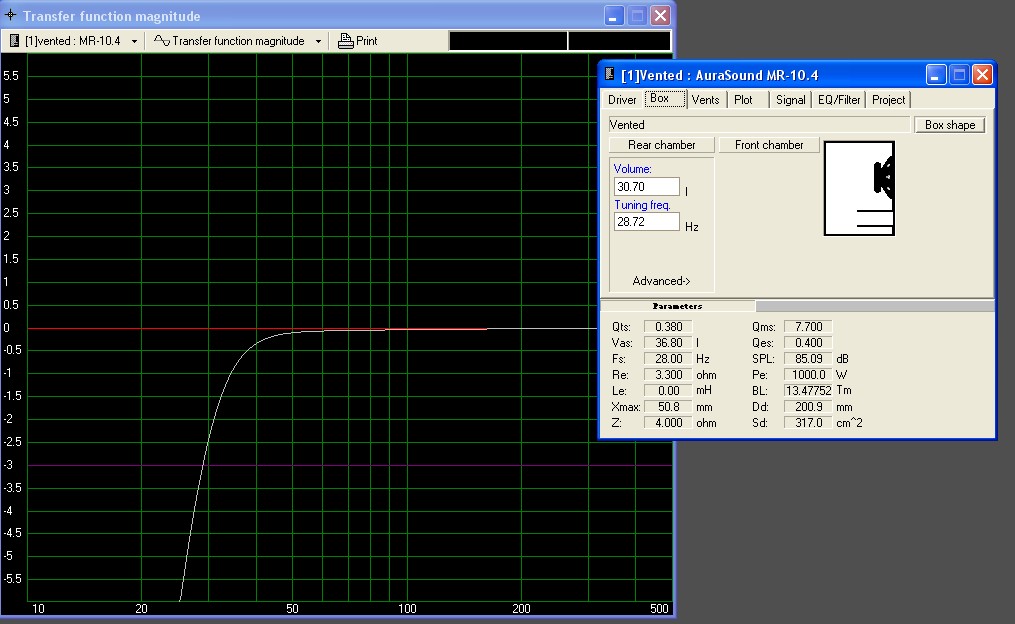

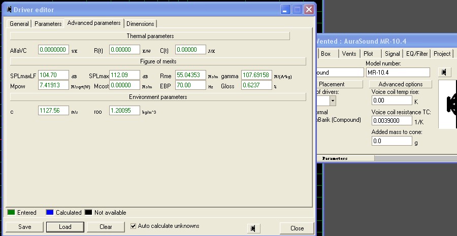

Mr. Choong Keat Yiang supplied this database for WinISD Pro and that is where I found it.  I presume that Mr. Choong was careful with this input:
He may have interpreted Xmax to be two-way with that figure.  Also, I gave the "consistency check" through WinISD's auto-calculate a try with that database, and it failed in every category possible.  If it were me, I would work the auto-calculate on these and see if several things are off by just a few hundredths or thousandths.
Update:  I entered those numbers (except I used 25.4mm for Xmax) into Unibox to see how it figured Mms etc and it came out about the same.

Yeah, I already checked aurasound.com, and I have the pdf for that driver, but they provide just enough data to build a basic enclosure. I am building a PR, and so I needed more advanced specs for it...
JBL Speakershop likes to have as much data about the driver as possible, for all the modelling purposes. Excursion, excursion limited output, phase... all that jazzz. Thanks!
