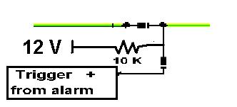

Your doortrigger input on your aftermarket alarm is positive or negative ?? This vehicule is doorpin closed circuit. It is posible your alarm goes off after 25 minutes ?? It is possible to isolate all the doorpin on this vehicule with diode and resistor. I cant make you a diagram.

This would be possible on later year F250's. Not on a 1998.

Is the same of all the year to 2006. I'm sure you connect on doorpin to domelight on positif trigger and your aftermarket alarm goes off after 25 minutes.
You need to go on factory doorpin. For example FORD 2004 F-250: DOOR FL : GREEN/ YELLOW, RL : Lt. GREEN/ YELLOW,
            FR : Pink/Lt.Blue, RR : Pink/Lt.Blue.
Like this :
Factory Ford Alarm Problem -- posted image.
