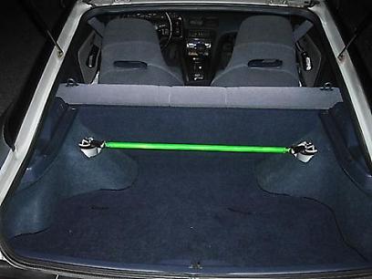

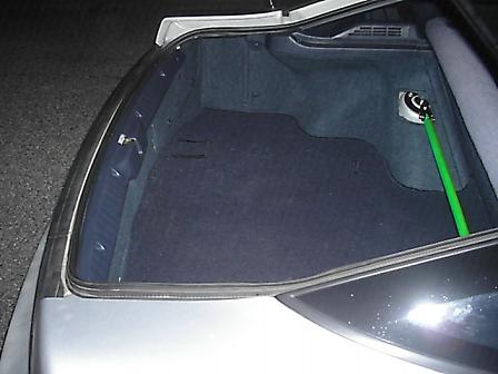

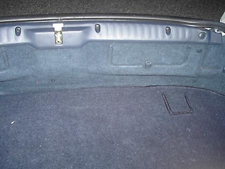

I figure I'll just make a bunch of enclosures the will fit in the back of s13 hatch trunks like this one..
89-93 240SX Interior -- posted image.
I want the box so that the back seat closes flush with the box where the seat meets the different fabric. I'm not too sure how i'd go about building the box, but im gonna shoot, maybe somneone could draw some work plans on those pictures for me? that would be a big help.

The enclosure size will vary in accordance to the optimum volume required by the subwoofers that you choose. Don't try to make the enclosure size fit the vehicle as this will make the subwoofer sound like crap if in the end the enclosure is too small or too big. You can cheat by filling it with Dacron filler if it's too small or add to the enclosure if it's too large, but plan ahead and you won't need to do either.
