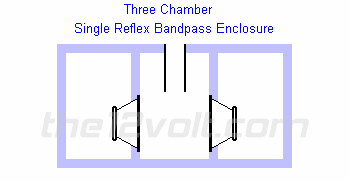

Keep in mind that most pass-through enclosures turn out to be a multi chamber single reflex bandpass enclosure (see the link below). So it will only be super loud at one frequency and not sound good at all. It is super impractical for a daily driver. Plus, $400 for a budget wont get you anywhere for what you want to do.
https://www.the12volt.com/images2/bpass3cham.gif

yes i am talking about the same "big hole cut in the cab of the truck" Ususally the hole that is cut is just a rectangle or square cut in the metal. That hole ends up being a port for the box in the truck bed. like it or not, its a port.
