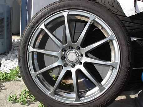

i went to tire rack and 18's fit on my car, here is a pic of the rims and tires the measurements are 235/40/18rHow do i fit 18’s on my civic? -- posted image.

Those won't fit. 235 is too wide and you will not be able to turn very far before the rims starts rubbing the innder fender guard. As well, your speedo will be out by quite a bit because of this size tire.

they dont rub the inside surprisingly, i had them on and drove around and it rubs only when i hit a bump and when the car tilts

Posted: July 31, 2006 at 11:47 AM / IP Logged
They are still TOO tall.....they are the wrong size.  AND what are the wheel measurments? If they rub AT ALL....they are the incorrect size, it's that simple.
