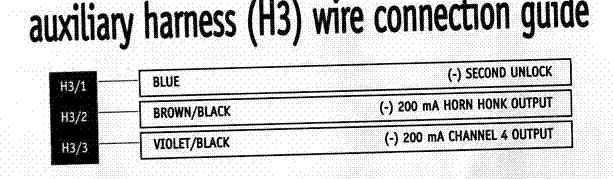

After further looking I found this in the install manual.
If the pic did not come out correctly it says there is (-) second unlock wire.
Progressive unlocking, Hornet 742T -- posted image.
I am not real sure what to do with H3/1 (blue wire). I am assuming I need to run it over the passenger kick panel and cut the unlock wire and attach it there.

look at page 19 in th einstall guide   aux harness has a 2nd unlock wire
