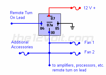

aznboi3644
Gold - Posts: 2,600
Joined: May 01, 2006
Posted: August 04, 2006 at 5:43 PM / IP Logged
hot amp possible fan? -- posted image.
stevdart
Platinum - Posts: 5,816
Joined: January 24, 2004
Posted: August 04, 2006 at 7:44 PM / IP Logged
There's your wiring diagram for the fans (I was going to post the same thing...complements of the12volt).  A lot of amps run warm to hot...that's just the nature of the product.  Use a push-pull configuration when you mount those fans.  One is pushing air toward the amp, the other is pulling hot air off the top.
