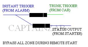

alarm goes off during remote start -- posted image.
I would recommend this, much easier and cheaper and saves space.
Doing it your way, leaves the green wire to trigger.
GREEN (-) Multiplex Input
Inputs shorter than 0.8 seconds will trigger the Warn Away® response, while inputs longer than 0.8 seconds will trigger full alarm sequence and report Zone 4.
To make sure, remote start and look at the LED flashes to see if i am right. (should see 4 flashes)

What captaizab says is right about the green wire on the shock sensor...........the way you are doing it, you'd have to install TWO relays, one to interrupt the green shock sensor wire, and another to interrupt the blue. Too much work.
One choice is to keep the relay setup you have, but instead interrupt the black (ground feed) or red (power feed) going to the shock sensor; that way, it cannot work at all when the remote start is on.
Another trick would be to forget the relay altogether......cut the shock sensor's black wire.......tape off or eliminate the side of the wire that comes from the alarm brain.......connect the sensor side of the black wire directly to the car's main ignition wire.
When the car's ignition is off, the shock sensor will receive an adequate ground to operate.....when the ignition is on, the ground goes away and the sensor doesn't work.
