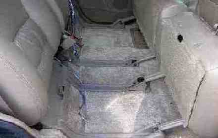

Snoracer is right on with what I want to do. The only other thing is I do not want to drill holes into the floor of the truck. I want to fill the wells under the seats just over the tranny hump to an even level so I can paint it to the color of the exterior of the truck, then fill in the gabs like Snoracer said with plexi. Then add neon to get a glow under the seats. I figure if I can do this I can mount the amps to the fabricated part and still use fold the seats down when needed. I would have posted a picture in the first post, but could not get it down to the right size. Here is one.

Let me try again. I have 2 amps, a cap, disto block and 2 crossovers to mount. Under the second row of seats is ideal due to the wasted space, not to mention plenty of room to lay everything out nice and pretty. The issue I am having is how to mount the componets. I do not want to mount them directly to the floor (screw into the floor pan). I want to build a low profile amp rack that fits under the seats. This way I can avoid drilling into the floor pan and also customize it at the same time. The goal is to have a smooth glass like finish on the rack that matches the exterior color of the truck. However the floor has many different levels (or humps if you will). So fiberglassing the floor is the only way I can think of to bring everything (the different levels or humps) up to the same level. Starting the rack is where I am sorta lost. If I use MDF then it will be rigid and very difficult to mold to the contours of the floor and if I lay down heavy plastic and foil and fiberglass to the floor of the truck then the smell is in there for ever. So I am not sure how to start. I hope this clears up any questions that linger. Once I get started then I can finish the rack to my liking, but first off I need help in getting started.

I would cut a piece of MDF to fit on each side, then use strips of aluminum (you can get them at lowes) to make brackets to hold the MDF to the seat bolts.  If you want to paint them, put a layer of body filler over the board, sand sand sand, and paint it.  Mount everything to your 2 pieces of MDF.  Once you start putting components under there, you will see you don't have as much vertical room as you think.  As for neon's under there, if you don't already have your amps, look into some that have built in lights.  these are often customizeable, or like PG amps, you buy the light bars seperate.
