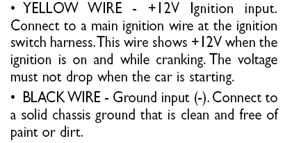

lock head -- posted image.lock head -- posted image.this is 3 basic wires to power up the system just little help your wire colors may be different . for a car alarm.
