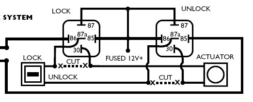

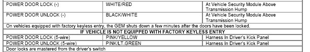

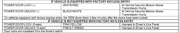

Hello to all i am installing a hornet 564t and i am having some confusion when it comes to the door lock/unlock. i have the wiring diagram but under the polarity section instead of saying positive or negative it says 5wi i do not know what this means. i am also using the second unlock feature that the alarm includes the second unlock is negative with 200mA (does that mean i need a relay). i know in order to achive this i need to sepreate the driver door unlock from the rest but i am confused with the polarity situation if anybody can help me i really appreciate it and thanks for the help by the way the truck is a 2007f350(same wirng as 2006) with factory keyless entry

F350 remote start door lock confusion -- posted image.

Posted: August 19, 2006 at 3:10 AM / IP Logged

Posted: August 19, 2006 at 3:13 AM / IP Logged

hello it is me again dea,can i have one question for you. the diagram you provided me is that how to wire the unlock/lock for the entire car or is that for just the driver door in order to seperate it from the other door locks once again thanks
dea,can
Copper - Posts: 284
Joined: January 12, 2006
Posted: August 19, 2006 at 8:08 PM / IP Logged
u have keyless entry  or no keyless entry
dragon
