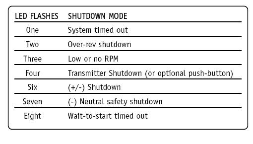

2002 Caravan, Avital 4200 -- posted image.
Read the LED. Im thinking its gonna show 1 or 3.
1 meaning that it just doesnt work, and probably because of wiring.
3 meaning not a good tach. try volt sense. or vice versa.
