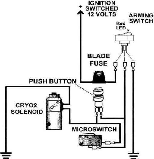

here is a wiring diagram for the bottle solenoid, I don't have one for the purge, but the purge is just hooked up into this circuit below.
multiple switch and relay setup -- posted image.

sorry, forgot to ask, where would I install the relay at on the circuit?

Posted: August 21, 2006 at 8:23 PM / IP Logged
Okay then, that helps.  To the left of the page, click vehicle wiring: https://www.the12volt.com/installbay/detail.asp?info=alarm&year=1989-90&make=Nissan&model=240%20SX&ID=18509&type=Alarm.  You can also check www.bulldogsecurity.com.  According to the link above, your horn wire is GREEN / WHITE (negative) at the steering column.
One thing I forgot- depending on the current draw of your solenoids, you may not need the other relays.  If the current draw of your solenoids is within the safe limits of the push button switches on your steering wheel, the relays will not be necessary.  If you find this to be the case, simply wire a fused ignition power where the solenoid is grounded, and use the switch to supply the ground.  If you do need to use relays, simply wire terminals 30 and 87 in place of where the push button switch is.  Connect the same fused ignition power to terminal 86 on the new relay.  Terminal 85 on the new relay needs to be connected to terminal 87a of the first two relays in my above post.

ok, where you said wire a new relay into the push button, will the relay replace the switch? because that switch activates the solenoid to release the C02!
I'm sorry I'm not understanding the part about if I need the relays!
ok that image i posted was just for the bottle solenoid, there is another item, the purge solenoid, that has 2 wires, pos. and neg., where would I have to place the wires at on the second relay for the solenoids at?

Yes, the new relay will replace the push button as it is in the above picture since the relay itself is a type of switch.  Then you'll just have to activate the relay using the push button as described above.
If you're not sure if you need to use a relay, use one to be on the safe side and not burn up your momentary switches.  Since switches are rated for current, exceeding the rating can fry the switch.  The purpose of a relay is to alleviate that problem, since it only requires a small amount of current (around 150-200 mA through the energizing coil) to control a much larger current (up to around 30 A for a typical automotive relay) through the contacts.  It's important that you understand this, so if you need more information, click on relays to the left of this page under basics: https://www.the12volt.com/relays/relays.asp.  Also have a look on www.bcae1.com, and scroll down to relays.
I think once you understand this, the purge solenoid will make sense to you.  It should basically be the same as the above diagram without the microswitch.  You'll have the purge solenoid, a fused ignition power source, and the relay/switch will supply a ground (completing the circuit).
