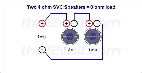

If you feel you really want the stocks connected, I would run the tweet/3.5" combination in series from the HU. You probably can't (and if you can, shouldn't, I think) run them parallel off of the HU. I don't know of any that can handle 2 ohm loads, plus, you don't want that much heat around your HU even if it could handle it. I'd connect them as follows:
Option 2 (series) = 8 ohm load
Speakers wired in series
4 channel Amp -- posted image.
I may be missing some other available option somewhere. But that's my 2˘.
