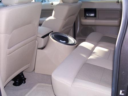

I dont have any build up pics, but I glassed all these from the inside:
fiberglass inside, instead of outside? -- posted image.

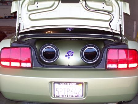

on this one I removed the bottom.

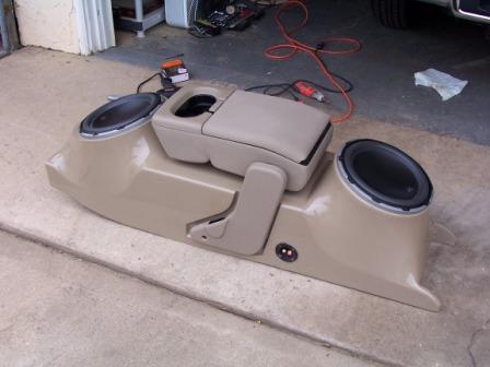

on this one I removed the back
removed the bottom as well
You get the idea. Next time I glass from the inside I'll make sure i take some build-up pics.

Nice work! Real smooth!   fiberglass inside, instead of outside? -- posted image.

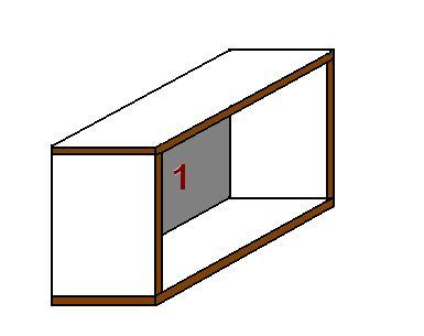

No I dont cut a section out. I build the frame work a certain way to allow a large piece of the mdf to be taken off but still have the rest of the frame maintain its shape. Give me a sec and I'll try to draw up an example.

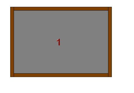

ok, lets say you build a basic rectangular frame. The opening in the front is where you mount your rings:
Dont glue the grey panel(1)in place yet. Just hold it in with screws till you get the shape of the framework you want. After your fleece is streched and resined you can remove the back panel(1). Now you have a large opening where you can lay down your glass from the inside. Once your done glassing put glue around the edges of the back panel and secure it back into place with nails/screws/etc.
Now this is a very very basic example. Sometimes you have to get a little more creative to make a frame with removable peices that can still maintain its shape without moving.
