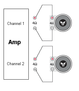

If you add the second sub using that amp you will not be able to bridge them (it would be a 2ohm bridged load and your amp is not stable at that rating). You would need to run each sub to it's own channel for the 25x2@4ohm rating. You will not like the way it sounds with only 25watts per speaker.

Hey thanks for the advice man. Saves me a bit of money!
But I really want two subs, I dont know where you are from but here we have XS Cargo, wholesale store kind of, and they are currently selling this 10" sub with a small amp.
I would like to take that sub put that up front and then put the kenwood back in the trunk with the original box.
Would this thing work, it should because its running on its own amp.
