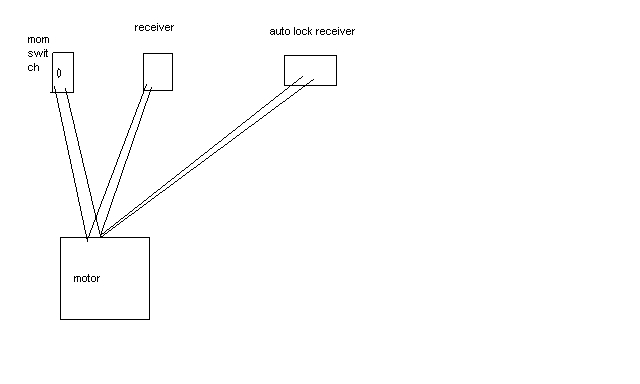

I have a garage door operated by a "bell push switch" which is basically a mom non latching switch n/o...I have taken a pair of wires from either side of the switch to an Autolock  12 volt 18 channel receiver to control the door remotely from the transmitter..I then wired the receiver with both wires on channel one so when the transmitter is pressed it opens the door..this works fine...however the mom switch will not operate anymore.
To confuse matters I also have two more receivers wired in to the same wiring operated by two seperate transmitters tied into a homelink system, I have a feeling these are a normally open system which may be confusing the circuit as i think the autolock system may be n/c as these other receivers also cease to operate..
The whole system works fine until i connect the Autolock receiver..
Any clearer?..stick with it..please  :-)

The garage door opener obviously needs to see the two contacts momentarily closed to operate in either direction, correct? If this is the case, each switch should be connected in parallel with the two contacts and not through the additional device you just added for them all to work. A diagram of how you have all of these wired to the garage door opener contacts would help us solve your dilemma.

Yeah, thats right, the garage door needs to be momentarily closed to open/close.
The other receiver works fine as it has the option of n/c & n/o on its wrining options.Tricky momentary  to momentary -- posted image.

If the Autolock receiver will work as normally open (like all your other switches/receivers), wired in parallel with all the other switches/receivers to the two contacts on the garage door opener and you should be good to go.

Posted: October 18, 2006 at 4:13 PM / IP Logged
Is it wired in parallel  at the moment?..sorry if thats a dumb question...
i think this is the issue, maybe the Autolock receiver is n/c which is why i may need a relay to make it n/o?
This may explain why the rest of the receivers/switch wont function when the Autolock systm is wired in..

Ahh, I see. I thought you meant the Autolock unit had the option of being normally open or normally closed. Since it's normally closed, wire it with an SPDT relay to its outputs as follows:
Connect one of the two leads of the Autolock unit to ground.
85 to the other lead of the Autlock unit
86 to 12V+
30 to one garage door contact
87a to the other garage door contact

BTW, connect all the other switches/receivers (normally open) in parallel with terminals 30 and 87a of the relay described above to the garage door opener contacts. When you activate the Autolock unit, the coil of the relay will de-energize and the normally closed contacts of the relay (87a and 30) will have continuity.
