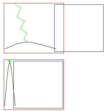

Here's a quick drawing of how it might be done. By putting the wiring into a flexible rubber line or some other type of tubing have it attached to a spring in the middle to the opposite wall. When the tray or amp rack is in the spring is pulling the tubing over to one side and when the tray is coming out the tube starts to straighten out but the spring is pulling against this so selecting the proper spring will be essential. If the tube is thicker than the thickness of the tray then it shouldn't get caught and want to roll under it and thinking about it find a tubing that will slide easily on the material you have chosen.
Jim
