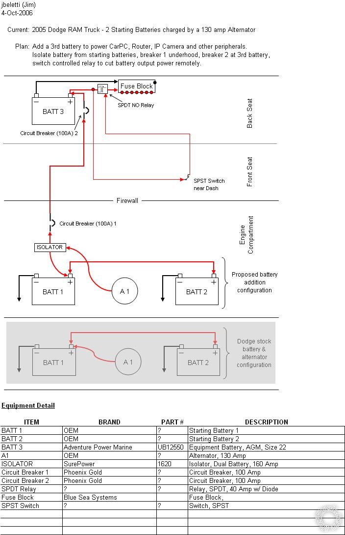

I installed an auxilliary battery in my 2005 Dodge RAM to power my toys (CarPC, Router, USB Hub, & IP Camera).  I used a Sure Power battery isolator, then ran 4 gauge wire from it to the aux battery.  100 amp circuit breakers used at each end of the positive cable.
Connected to the aux battery is a 12 position Blue Sea Systems fuse block.  I used short lengths of 4 gauge wire from the positive and neative terminals of the aux battery to connect it to the fuse block.
Now I want to install a small dash mounted switch to cut the power at the input of the fuse block.  I have 30 amp relays with and without diode as well as the switch I want to use.
Question is, what is the best way to interface huge 4 gauge wire to the male spade terminals of an automotive relay?  I did not buy a wiring harness/connector for the relay but I could pick one up.
Technically, I don't "need" to use 4 gauge from the battery to the fuse block.  I had the wire and I had the copper lugs and solder slugs as well as heat shrink, a torch and heat gun so I used what I had and made it nice, if not over-built for my small overall load.
I was thining of make a short jumper with a female spade terminal on one end and a ring terminal on the other end.  I'd connect the spade terminal to the relay (pin 30) and bolt (?) the ring terminal to the copper lug fro the 4 gauge battery jumper.  Does this sound viable?
In fact, when I was wiring in the battery isolator, I removed the Dodge supplied output jummper from the alternator to the battery.  Interestingly enough, it was about 4 gauge and reduced way down to a ring terminal to connect to the bolt on the starting battery terminal clamp.  So I guess this has been done.  Maybe I should just use that jumper and replae the ring terminal with a female spade?
Just worried aout the stress applied to the relay terminals by medium to heavy gauge wire.  Maybe the harness is the way to go.
Any input/validation is appreciated.

I have already prety much completed the install that was in the image. So I already have the Sure Power isolator - no need for the soleniod.
I'm relly looking for input on ideas for connecting 4 gauge wire to a relay. Big wire to tiny spade terminal.
If you are saying to use a soleniod for that, I am not sure what I'd need a solenoid for that. Sorry if I am misunderstanding.

I looked at the Bussman PDBs. If I could find one locally, that would work.
Cutting down the 4 gauge to fit a spade terminal would also work but there may be too much stress on the connector with that huge cable.
As for using a solenoid instead of a small relay - now I am getting what you are saying. That said though, my max load is 15 amps. No amplifiers or any other high in-rush current devices. So with 15 amps max on a cheap 30 amp cube relay, is that still too much?
