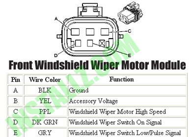

Hey guys,
I am doing a wiper protection on a 2001 Chevrolet Silverado. I am looking for the wiper wire. Any infomation on the colour, location...etc. is much appreciated. Thanks guys.

Posted: October 25, 2006 at 9:12 PM / IP Logged
2001 Silverado, wiper wire info -- posted image.

Thanks NowYaKnow, metz35,
I'll will give it a shot at the info. above.

Posted: October 30, 2006 at 2:38 PM / IP Logged
For future reference.
Thanks again guys for the info. above. I couldn't find the correct wiper wire against the above post. However, if you trying to do a wiper protection for this vehicle. All you have to do is power up the Accessory 1 - Orange wire. Accessory 2 - Brown is not necessary. Wiper will not activate unless the Brown Accessory 2 wire is power up.
