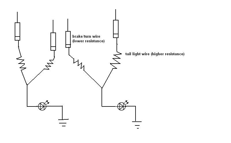

can you show via a rough diagram? i have 3 wires from my car. a brake/turn, a tail and ground. the bulbs i am using are 16000 mcd. so how would i run the resistors? please forgive all the ?'s but im a noob at leds.

Anyhow, let me know if you think this diagram will work. I used diodes to isolate the turn/brakes.

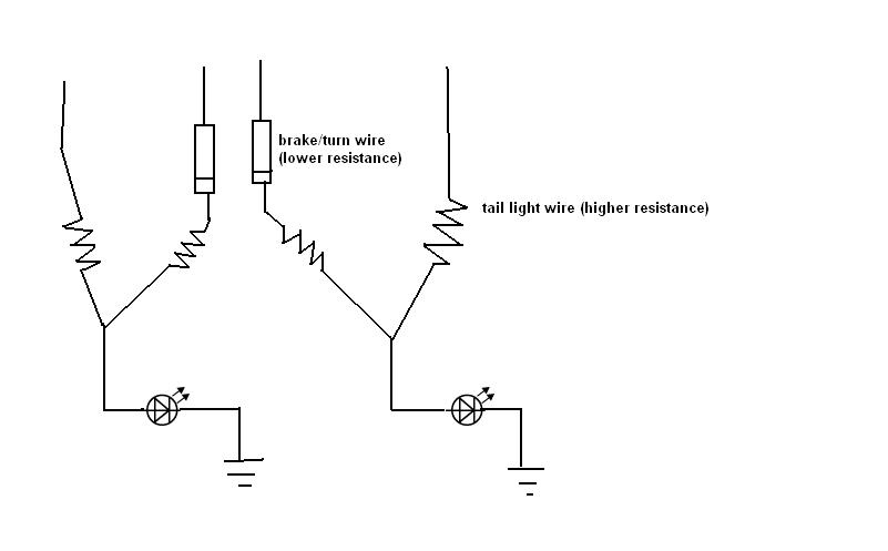

Wait, This diagram makes more sense to isolate the tails from the turn/brake.
