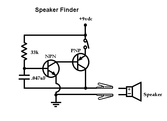

Here is a circuit that will cost about 10 bucks and will help you find unknown speaker wires in a car.
It is an Audio Generator or otherwise known as an Audio Oscillator.
It just puts out a simple tone so you can find the speaker wires.
The Transistors I used were out of an old car stereo in the scrap pile and my cost was nothing.
Cheap Speaker Finder -- posted image.

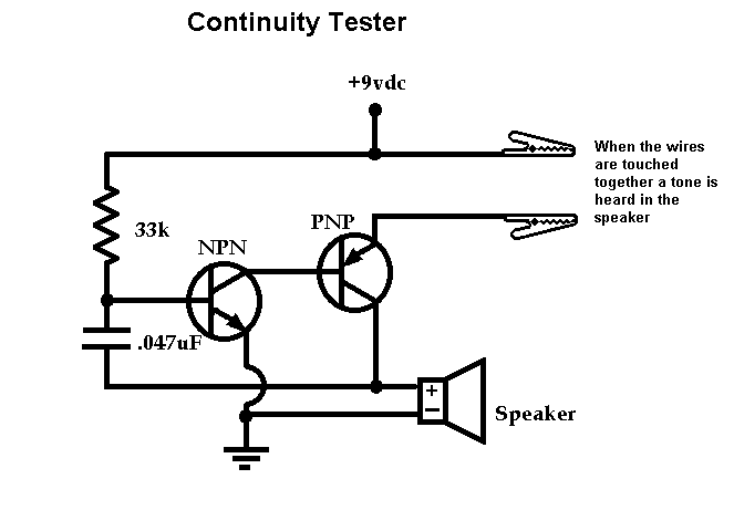

You can use the same Circuit as a Continuity tester for wires and fuses, etc. by rearranging the wires.

fancy
I usually just pop the speaker wires with my 12v drill battery
your way is much cooler
sin0cide
Copper - Posts: 49
Joined: August 03, 2006
Posted: November 05, 2006 at 8:03 PM / IP Logged
what about amplified systems? wouldn't your 12volt battery or this continuity tester toast the amp?
hotwaterwizard
Silver - Posts: 1,350
Joined: December 11, 2003
Posted: November 06, 2006 at 1:45 AM / IP Logged
Not if you use two 1.5 volt batteries instead of the 9 volt.
An amplified system will accept up to about 3 volts without dammage. But, the amp is not on when the hot lead or remote is not connected. You can use a capacitor of 1uF on the output as isolation if you are really concerned with this.
