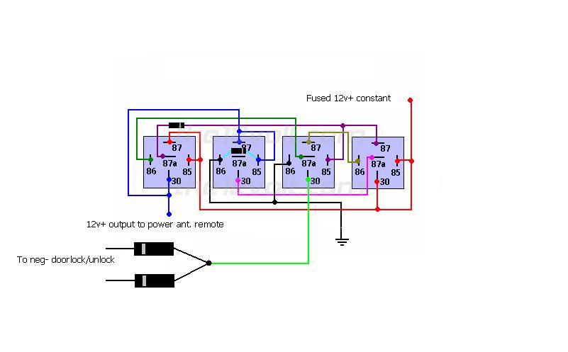

Wondering if Momentary to Constant setup is acceptable to actuate a power antenna, upon turning car off? Thinking if had cap/resistor setup to bleed voltage for the time for it go up/down should be just fine (I've timed mine at ~4sec). I'm thinking of using the door switch actually trigger the antenna down (have it go down when open the door with car off) and in my case go up on unlock signal from remote (armed) and actuate on door open.

You won't need any caps or resistors to do this..diodes and relays at most. However I need to know what kind of vehicle this is (make, model, year) and if the power antenna is factory or aftermarket.

I need one more piece of info.
Is the factory power antenna fully automatic, or manual (you need to use a switch for up/down)
The reason I ask is that it might not be that simple if it's a fully automatic. whats happens with a fully automatic antenna is that once the "trigger" wire loses power, it goes down,
So if we use any kind of timer or latching relay circuit, the antenna will go down eventually, either when it times out, or once the door is closed. Perhaps I can design a circuit that can also kill the main power to the antenna motor once it's up, then reactivate it for down.
But before I rack my brain on that one, if it is a manual power antenna, or if you purchase one (they are not expensive, I can use a latching relay circuit along with a reverse polarity and it should work.

I thought of an idea. If it is a fully auto antenna (which it should be) try this. How it works is when you unlock the car with the remote..the antenna will go up.  Lock car with remote...the antenna goes down. Let me know if this will work for you.

Is not fully auto, you must hold button for it to go up or down just like a window.
