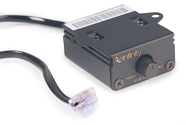

if it is bad rca's, couldnt i just take them out and put in a bass control remote thingSubwoofer Rumble -- posted image.

Posted: November 20, 2006 at 6:32 PM / IP Logged
Uh... no.  No offense, but based on that comment I suggest you need to take your car to an install shop in your area and get some help making sure your system is installed and setup properly.  Seriously.
