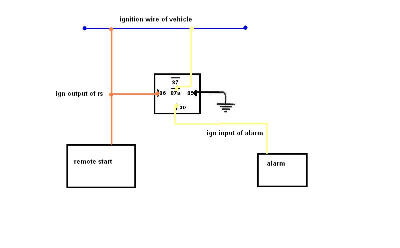

master5
Silver - Posts: 1,123
Joined: October 10, 2006
Posted: December 02, 2006 at 12:32 PM / IP Logged
If you remote start does not have an ignition bypass of the appropriate neg. output wire..use this method...simple

master5
Posted: December 02, 2006 at 12:36 PM / IP Logged
gcguy...hope that helped.
sorry the other circuit was wrong..been a long week..lol
