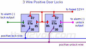

I just fitted a auto page alarm (rs-860) to my mitsubishi lancer,remote start everything is working fine.Only thing is the central locking is real confusing!My central locking is neg pulse operated and there are 3 wire coming from the brain for this,a blue,green and red one.Only problem is i just cant wire the bloody thing up.The installation manual just makes no sense.
Any help would be really appreciated

Wire your relays like this EXCEPT pins 87, and ONLY 87 go to ground (earth) everthing else is the same .by switching 87 to ground, 30 becomes a negative output. Tak these to you neg lock/unlock wires on your car.
